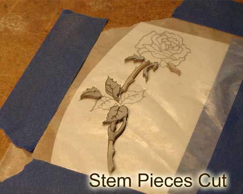

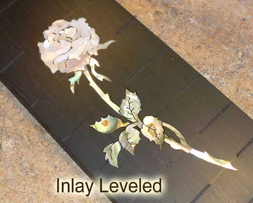

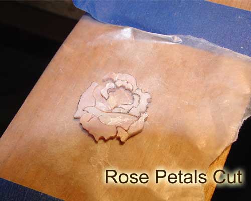

   I just inlaid a Rose and Stem into a fingerboard that will end up on a Ryan Cathedral being built for a player who owns a pair Omega guitars that he'd purchased from me.
   It is an inlay that has landed in several guitars over the years including my very first acoustic guitar build. It is in the fingerboard of an MJ that Steve Wiggins used to record all of the acoustic tracks for Big Tent Revival's recordings and still uses as his main guitar to this day. It also was inlaid into a guitar for the partner of Herb Chapman in Chapman's Music in Paducah, KY. Herb is father to Steven Curtis Chapman and is a very close friend of mine. His partner, Keith Rose had a dozen roses inlaid in his commissioned guitar, all of which were variations on this design connected by a vine of thorny stems and lots of green Abalone leaf clusters. His inlay ran all the way up the fingerboard anthrough the nut into the headstock.

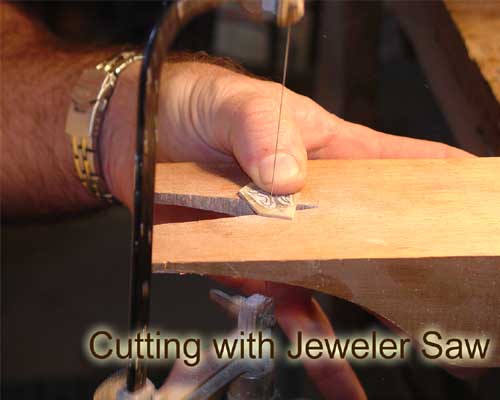

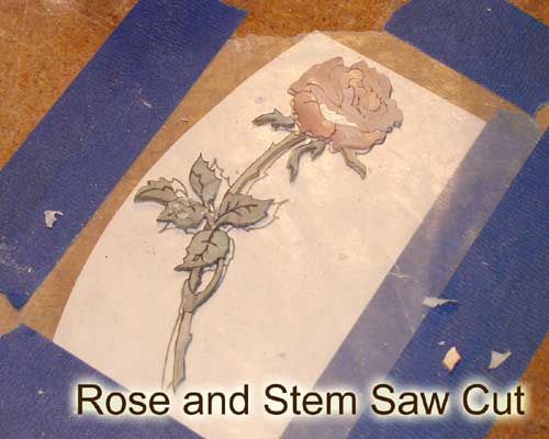

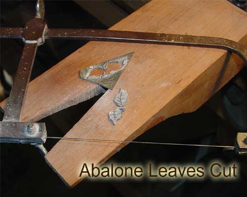

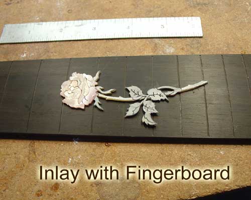

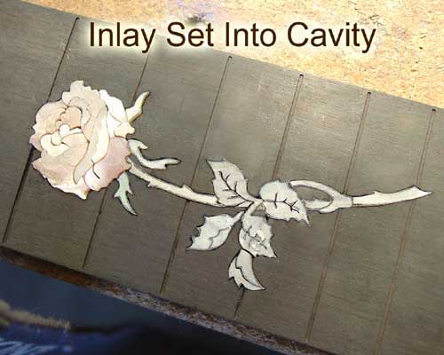

   Here's a quick photo sequence of me executing this most recent Rose inlay.
   This may be of some interest to those who may have been considering breaking into the craft or art of inlay to adorn their guitars as they build them.
   I teach a three day class specifically on inlay techniques, tools and methods a few times a year and they're always fun. Those classes are usually attended by people who have taken my one week building class and have begun to build on their own.

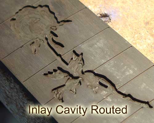

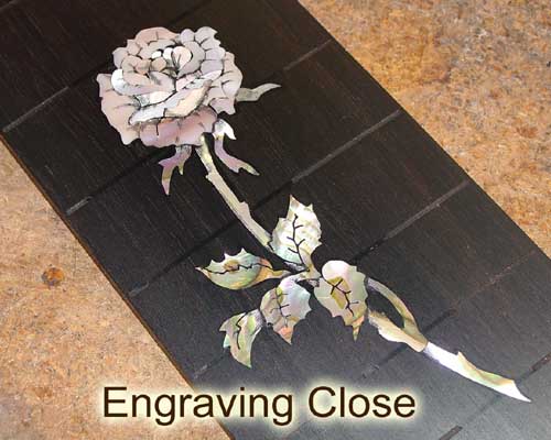

That is just beautiful Kevin. Is this for the orphanage guitar?
So, after you get it all inlayed, how do you cut the slots? dental bur?

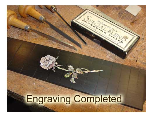

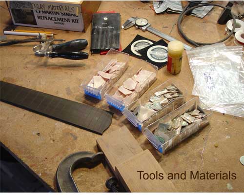

Beautiful Rose Kevin! Very helpful pics as well.   Do you glue down the pieces to the fingerboard before you scribe the outline around them? If you do glue them down, how do you get them up?
Where do you get stuff like that special blend engraving filler? Does that box read William Laskin on the top, and is that Grit?

    The engraving filler is from Grit Laskin...or was. He was offering it back in the early 90s and he gave me a box at the ASIA Symposium when it was held here at Lafayette College in Easton, PA...1992?...93?. I later bought a dozen boxes to have on hand...not knowing how long one would last.
    Well, I have only opened two of the boxes and I have done alot of inlays since getting them. There's one at either end of my shop on a shelf and neither shows signs of running out yet(I've only used a single stick in each box).I gave a couple away to friends who took my class, but have held onto the rest since I heard that it isn't available anymore.
   I'll have to check with Grit to see if he is selling it now. it's a very densely pigmented crayonlike stick that is metal based from what I understand. You just smear it into your engraving and then scrub off the excess to reveal the intended engraving lines. Under finish or unfinished, it stays put and doesn't rub out under playing. If an inlay shows signs of having the engraving wear off due to play contact, it's not a big task to recut the engraving lines and fill them.

StewMac is selling it.
Laskin Inlay Filler

Stewart McDonald carries it.
Laskin's Engraving Filler

StewMac now sells the Laskin filler: Item# 4406 Laskin's Engraving Filler
I gather from your photo that you CA all the pieces up on wax paper overlayed on the drawing? Then tack glue the inlay composition to the fretboard for scribing?

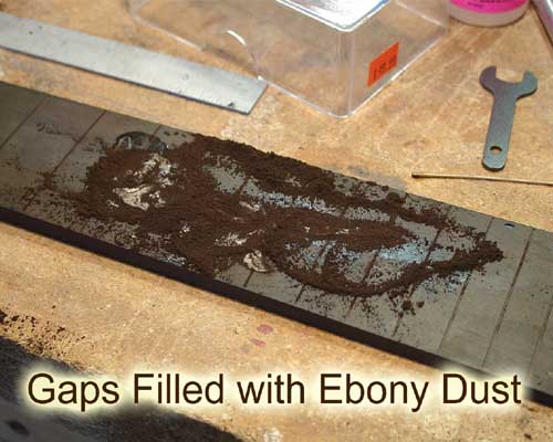

Was the Rose glued up with CA, dyed epoxy or was it filled with ebony dust?Anthony Z38790.4016666667

   Yes, I usually lay all of the pieces over the drawing that is taped down under wax paper to keep track of what I still need to cut. When all are cut, I dress whatever needs to be touched with jeweler's files and fit them together. Then I CA glue them together on the wax paper being careful to keep the glue light to avoid running between pieces and additional cleanup before tracing it onto the surface it will be laid into.
   I glue the entire assembled inlay onto the fingerboard using Duco cement and allow it to dry for a few hours. After cutting the tracing around it, I use a small spatula to coax it off of the board again. If it comes aprt, it's usually only a part or two that work loose so it's easy enough to get together again.

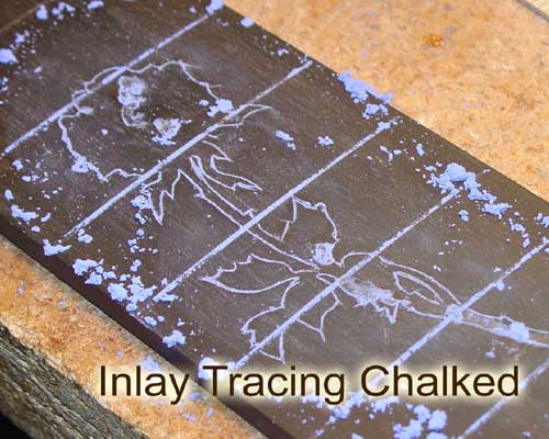

I never use a scribe to trace the piece onto the surface, but always use an Xacto knife with a fresh blade to cut a line around the item being inlaid. The scribe will press the line into the surface by mashing the material down or can scrape a very small goove into the surface by dragging material out. The Xacto knife actually cuts the line into the surface very cleanly and during the rout of the cavity, provides for a clean line to chip to and an even cleaner shearing action for the downcut edges.
   I always fill gaps withvery fine ebony dust and then drip in thin viscosity CA glue. Once the surface is covered, I usually sprinkle more dust on top of the wet glue allowing the glue to wick it into the low surface areas.

If I were to critique anything it would be the channeling job. There are some rather large gaps. These are easy to hide in ebony, but get much tougher to hide in rosewood and any other wood. I agree with Kevin get away from the scribe and use an Exacto knife. I also glue up the inlay after fine fitting with jeweler files then glue the inlay down with Duco and trace with the Exacto knife.
Good tight channeling is essential to inlaying on lighter woods and a cut edge makes it easer to keep to the shape. When I am channeling for binding or purfling I like a heavy tool, but when channeling for fine detailed inlay I prefer my foredoom because it is light and easy to control. I take great pains to rout the outer perimeter very carefully to the pattern and not past it anywhere. It is a painstaking procedure but make all the difference.

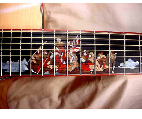

   Here's another small inlay I did a few years ago. It was inspired by Emanuel Leutze's "Washington's Crossing"
painting.
